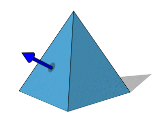

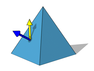

   -- First get the face normal vector.
   -- It is shown in BLUE on the image
   faceNormal = in coordsys theObj (getFaceNormal theObj theFace)
   -- This is the desired up vector in world space

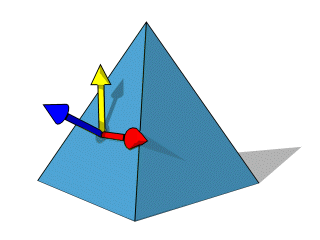

   -- It is shown in YELLOW on the image
   worldUpVector = [0,0,1]
   -- Now get the cross-product of the face normal and the up vector.
   -- This will give you a vector that is perpendicular to the plane defined
   -- by the normal and the up vector. Normalize it to get a normal vector
   -- pointing to the right.
   -- It is shown in RED on the image
   rightVector = normalize (cross worldUpVector faceNormal)

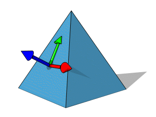

   -- Note that this new vector can be seen as the SHADOW of the World Up vector
   -- on the face of the object in the above image.
   -- It is now displayed in green in the image below:
   upVector = normalize ( cross rightVector faceNormal )
