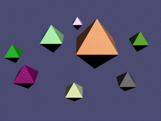

To use the script, create a scene with a couple of spheres and set their segments count quite low (as low as 4). Render the scene – all spheres should look exactly as they do in the viewports. (See first image). Then execute the SphereSegsOn script – nothing will change in the viewport, but if you render the scene again, all spheres will appear completely smooth. (see second image). Execute the SphereSegsOff script and the rendering should return to normal.
