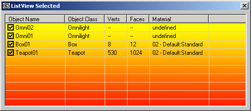

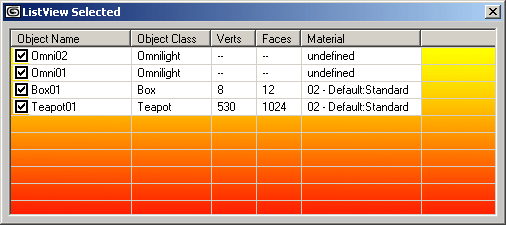

.Picture : IPictureDisp
Lets you assign a picture to the background. See loadPicture for details on passing pictures as IPuctureDisp values to ActiveX controls.
In the example below, a yellow-red gradient with the size 500x200 pixels was created in Photoshop, saved as 24 bit BMP to disk and passed to the .Picture property using the line
lv.picture = loadPicture "c:/3dsmax6/images/activex_gradient.bmp"
.PictureAlignment : ListPictureAlignmentConstants( #lvwTopLeft | #lvwTopRight | #lvwBottomLeft | #lvwBottomRight | #lvwCenter | #lvwTile )
Controls the alignment of the picture assigned to the .Picture property.
.TextBackground : ListTextBackgroundConstants( #lvwTransparent | #lvwOpaque )
Controls the appearance of the text background. When set to #lvwOpaque, the above example will appear as

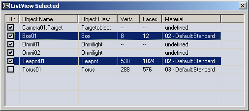

.FullRowSelect : boolean
When set to true, selecting an item or sub-item will select the complete row. When set to false, only the ListItem (first column) will be selected.
.MultiSelect : Boolean
When set to true, the user can select multiple ListItems simultaneously. When set to false (default), only one ListItem at a time can be selected.
