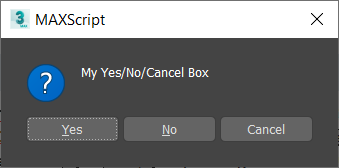

yesNoCancelBox <message_string> [optional arguments - [see below] ](GUID-7A4AA91A-0DEB-470B-AD6B-2E7A3A105BD0.html)
Displays a modal message with Yes, No, and Cancel buttons. The yesNoCancelBox() function returns #yes, #no or #cancel depending on which button the user selects.

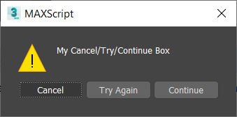

cancelTryContinueBox <message_string> [optional arguments - [see below] ](GUID-7A4AA91A-0DEB-470B-AD6B-2E7A3A105BD0.html)
Displays a modal message box with Cancel, Try Again, and Continue buttons. This dialog returns #cancel, #tryAgain, or #continue, depending which button the user selects. Available in 3ds Max 2020.1 Update and higher.

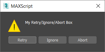

retryIgnoreAbortBox <message_string> [optional arguments - [see below] ](GUID-7A4AA91A-0DEB-470B-AD6B-2E7A3A105BD0.html)
Displays a modal message box with Retry, Ignore, and Abort buttons. This dialog returns #retry, #ignore, or #abort, depending on which button the user selects. Available in 3ds Max 2020.1 Update and higher.
