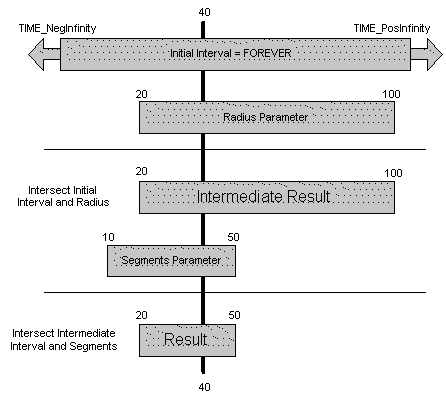

The GetValue() method of IParamBlock has several parameters, one of which is a C++ reference to an Interval. This method is frequently used by developers to 'whittle' down an interval. When a parameter of a parameter block is animated, for any given time there is an interval over which the parameter is constant. If the parameter is constantly changing the interval is instantaneous. If the parameter does not change for a certain period the interval will be longer. If the parameter never changes the interval will be FOREVER. By passing an interval to the GetValue() method of the parameter block you ask the parameter block to 'intersect' the interval passed in with the interval of the parameter. Intersecting two intervals means returning a new interval whose start value is the greater of the two, and whose end value is smaller of the two. In this way, the resulting interval represents a combined period of constancy for the two intervals.
This technique is used frequently to compute a validity interval for an object. The developer starts an interval off as FOREVER, then intersects this interval with each of its animated parameters (by calling GetValue()). GetValue() 'whittles' down the interval with each call. When all the parameters have been intersected, the result is the overall validity interval of an object at a specific time.
Consider the example shown in the diagram below. A validity interval is computed at time 40 for an object with two animated parameters, Radius, and Segments. The interval is computed by first intersecting an initial interval of FOREVER with the Radius parameter. The Radius interval is from 20 to 100. The result of this intersection is the interval from 20 to 100. This interval is intersected with the Segment parameter interval (from 10 to 50). The result of this intersection is an interval from 20 to 50. Thus the validity interval of the object at time 40 is from 20 to 50.
