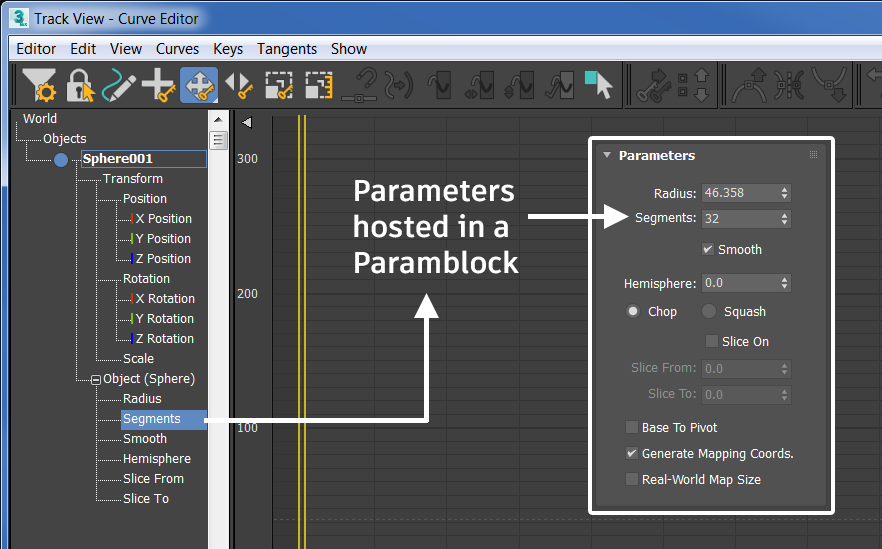

The following image demonstrates how parameters can be accessed from multiple locations such as the track-view and the roll-out:
