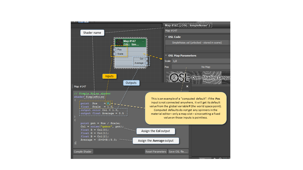

OSL by default works in a "common" coordinate space that can (in theory) be different from renderer to renderer. In practice, most renderers use world space for this coordinate space, and this is true also for the OSL Map.
This means that the OSL global parameter P is in world space. Many shaders use the above mentioned feature of a computed default so that the shader works immediately, by having a line such as
vector Input = P
This will make the Input parameter have the world space point as a default. Since texturing things in world space may not be what a user expects (since moving the object would drag it "through" the texture space, it is probably more useful to most users to instead use object space, which would look like this:
vector Input = transform("object", P),
Or, if it is a 2D texture, use the default UV space since 3d Max populates the global OSL variables u and v with the default 3d Max UVW map channel 1:
Also, since in theory (according to the OSL specification) P is in "common" space, and you actually want it in world space, the correct way of transforming it is:
vector Input = transform("world", P),
However, in the OSL Map's execution environment, this does nothing, since P is already in world space.

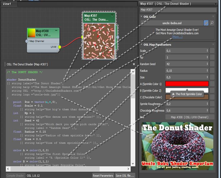

In OSL metadata can be assigned to whole shaders, or individual parameters. 3ds Max supports a subset of those metadata settings, as well as some of its own.
For the shader, the following metadata are supported
| Name | Meaning |
| label | The "display name" of the shader. This is what is displayed the Material Browser, as well as the title in the Material Editor and on the node in Slate Material Editor. |
| help | A short help text displayed the top of the material editor. This can contain a subset of HTML formatting. |
| URL | A link to a more extensive help page about the shader. |
| logo | An image loaded from the same folder as the OSL shader, and displayed at the bottom of the material editor in place of the default logo. This Allows you to personalize the look of your shaders, or even include a sample image of what it does directly in the UI. If the file cannot be found, the default logo is displayed. |
| category | Sorts this shader in a particular category in the 3d Max Map browser. By default, categories are determined by the subdirectory the shader is in, but this can be overridden by a specific category metadata value. It allows nested categories separated by a backslash, for example "Math\Color" puts the in the "Math" category, with a sub-category of "Color". |
| version | The version number of the shader. It should be a string of up to three dotted numbers (e.g. "1.3.11") to encode the version of the shader, although a float or integer version number also works. A shader with no version metadata is considered as version zero. |

Here is a visual example of how metadata shows up in an OSL shader:

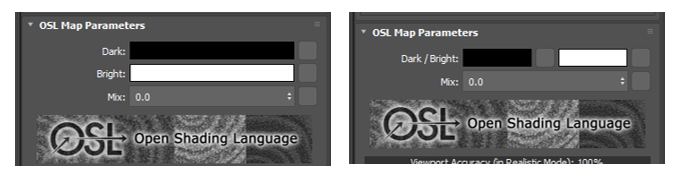

By default, one parameter per row is displayed. This tends to make the UI very "tall" with a lot of scrolling around for shaders with lots of parameters. But sometimes parameters are related to each other (e.g. a multiplier and a color) which makes it desirable to be able to put multiple controls on the same row.
To facilitate this, use the metadata packName. It decides which parmeters to "pack" into the same row. Any two or more parameters that have the same "packName" will show up on the same row, with that "packName" as the row header. To additionally size the columns as needed, the metadata widgetWidth allows some amount of adjustment of the relative size of the widgets, to keep the layout looking balanced.
In the below example, on the left, the Dark and Bright parameters are on separate rows. But on the right, both of them have been given the packName of "Dark / Bright", putting both on the same row, with that heading:

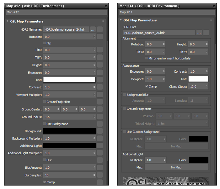

The user interface for OSL now allows a custom layout to be provided in the form of a .ui file.
HDRI Environment shader with no custom UI (left) and the custom UI (right):
If there is no .ui file, or if the shader was loaded into an earlier version of 3ds Max (or even another software entirely) it would look like on the left. But by supplying the file HDRIEnviron.ui in the same folder as HDRIEnviron.osl, we get the result on the right.
