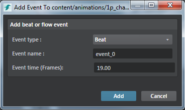

Open the Animation Clip Editor.
Right-click on the timeline, and select Add Beat > New Beat or Add Flow Event > New Flow Event.
In the options that appear, set the following:
(All events that you add – you right-click to create the event type/marker type.)
The beat or the flow event is set to the timeline and upon selection, you can view its properties in the Property Editor.
Click the beat or the flow event on the Clip Editor timeline.
In the Property Editor, select a different flow event in the Name field or set a new time.
