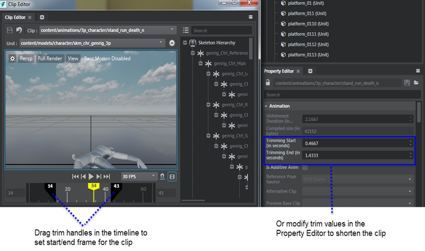

You can trim animation clips in the Animation Clip Editor to edit the length of the animation frames.
To trim an animation,
Do either of the following:
The Asset Preview now plays the trimmed clip. The animation Clip Editor still contains the full length of the animation, and you can restore the clip or retrim as desired.
