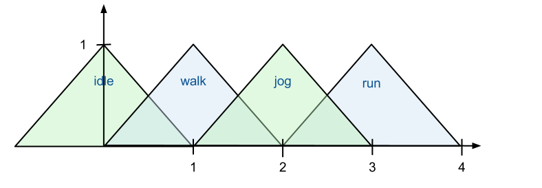

The mathematical language used for expressions has four functions for facilitating blend states that mixes different animations based on the value of a variable: match(), match_2d(), match_range() and match_range_2d()This is a sawtooth function that is 1 when the variable matches the constant. It falls off to zero within a distance of 1 from the constant value. If you are further away, the function is zero.
You can use this to switch between a set of animations based on the value of a variable:
walk match(speed, 0) jog match(speed, 1) run match(speed, 2)
Now you can select which animation to use with the speed value. A value of 1.3 will blend 70% of the jog animation with 30% of the run animation. Note that for this to work, the constant values that you match against must increase by 1 for each animation. This guarantees that the sawtooth shapes match up so that the jog animation starts to increase when the walk animation starts to fade out.

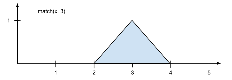

Gives you a sawtooth which is at 0 % when x == t0, ramps up to 100 % when x == t1 and ramps back down to 0 % when x == t2.
match(x, t) is the same as match_range(x, t-1, t, t+1).This function works as match_2d(), but lets you specify the shape of the sawtooth for each variable, just as you can do for one variable with match_range().
