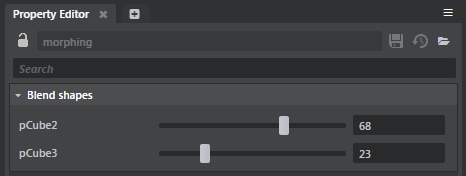

Select the blend shape asset.
Your targets appear in the Property Editor.
Move the sliders to adjust the amount of influence each of the target shapes has on your base object.
Click
to save your changes. Your changes are visible in the Asset Preview.
