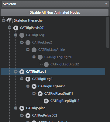

Choose Skeleton in the drop-down list to set which of your skeleton's nodes should be animatable and which should not.
When you disable a node, it will never play any animation contained for it in any animation clip that you play on that skeleton. It will freeze in local space. Disabling nodes that you don't need to animate can be useful in order to optimize the memory and performance of the animation system.

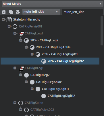

Choose Blend masks in the drop-down list to set up your skeleton's blend masks, which control the blending between different animation layers that are playing at the same time on a skeleton.
Each blend mask stores a weight value for each node in the skeleton. You can assign one of these blend masks to each animation state in the animation controller that controls this skeleton. When you have two or more animation layers that need to play different states on the same skeleton at the same time, the blend mask that is assigned to each state controls how strongly that state is weighted when coming up with the final result for the skeleton in each frame:
Use the control strip at the top of the panel to manage the blend masks that are available for this skeleton, and to select a blend mask whose weights you want to edit:

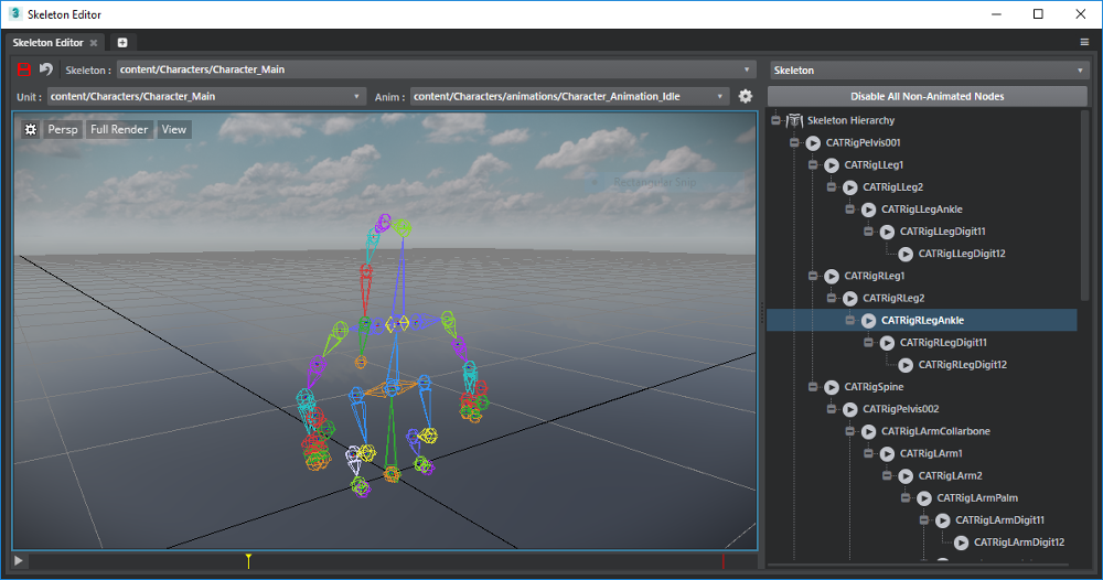

The viewport of the Skeleton Editor panel shows a preview of the changes you make to your skeleton's animation settings. You can use the preview controls to change what you see in the viewport:
A skeleton can apply to multiple units in your project. By default, the panel will choose one of those units to show in the preview viewport. You can use the Unit drop-down list to change to a different unit.
Use the Anim drop-down list to choose which animation clip you want the preview viewport to play on your chosen unit.
Use the settings icon to control other display settings for the preview viewport, such as the playback rate, whether to evaluate the selected unit's Unit Flow graphs, and whether to enable physics.
Use the timeline control at the bottom of the panel to start, stop, and scrub the current animation clip.
None of these settings affect the skeleton resource itself. They only change the preview that you see in the viewport.
