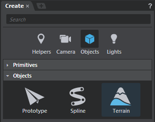

From the Create panel (Window > Create), select the Objects category, then select Terrain from the Objects sub-category.
In the New Terrain options that appear, set the following and click Create:

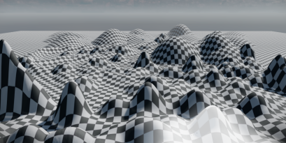

The editor creates a terrain plane unit in the level, with a default checkerbox material assigned. This default material (core/stingray_renderer/shaders/terrain_basic) sets up the connection between the material map and actual textures. In the Asset Browser, you can see the terrain unit, its material, and the associated textures.

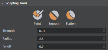

New terrain Sculpting Tools display in the Property Editor, and you can immediately start to paint the height and material maps in the Level Viewport. The terrain plane updates as you sculpt.
| Sculpting Tools hotkeys | |
| Enter paint mode | B |
| Brush radius | B + drag |
| Brush falloff | N + drag |
| Brush strength | M + drag |
| Lower terrain (only in paint mode) | Ctrl + drag |
