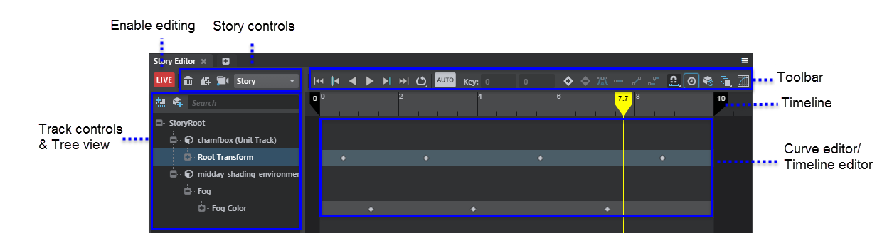

This editor consists of the following main areas:
Refer to the sections below for more detail on each area.

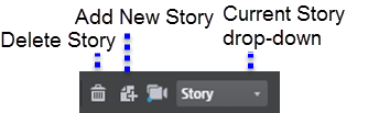

to add a new Story to the editor. If you select a unit or entity before clicking
, the editor automatically adds the unit or entity to a new level object track within the story.
When working on multiple stories within a level, use the Current Story drop-down to switch between them.

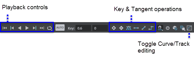

The Story Editor toolbar includes the following:
| Controls | Description |
Playback Controls ![]() |
Use the playback controls to preview animations in the Level Viewport, as you edit the unit animation in the Story Editor. Use To change the playback mode, select , right-click to select Loop or Ping Pong. |

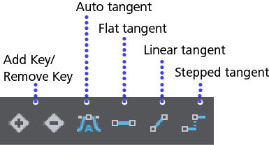

Key & Tangent options ![]() |
Use the key and tangent options to add or remove keyframes and tangent modes. |

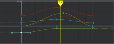

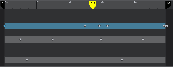

Use the curve icon in the toolbar to switch between the different editing views in this area. Curve editing mode: Tip: Select keys on the same curve and enter a value in the edit key field on the toolbar to edit multiple keys at once. Key editing mode: ![]() |

Use the tree view to browse and select stories, tracks, and properties for keyframing. The tree view includes a small tool bar with a search panel, and the following options for adding tracks:
Add level object track
Use level object tracks to organize the keyframe animation for each unit or entity added to the story. A unit track is automatically created if you select an object before clicking
An entity track is automatically created if you select an entity before clicking
Right-click level object tracks to add more properties for animation, including the object's material properties.
