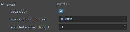

In the viewport, select an object with cloth and then select the settings.ini file.
Turn on apex_cloth in the Property Editor.
You can also manually configure the cloth simulation budget using the attributes in the settings.ini file. See settings.ini file reference for more information.

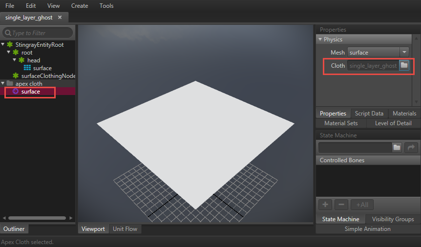

Associate APEX cloth defintion to the unit's meshes.
Either select Create or right-click the mesh to select Add APEX Cloth Resource.
A cloth resource is created and is visible under the 'apex cloth' section in the Outliner.Select the cloth resource and in the Properties Panel, browse for the corresponding cloth definition (.apx files) to bind to the mesh.
