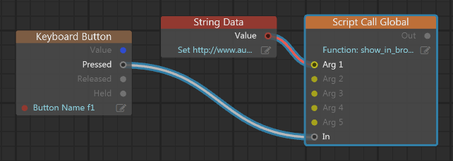

You can call any global Lua function from Flow without having to create a custom node, by using the Script > Script Call Global node. You can pass up to five arguments to the Lua function by hooking up data connectors to the input slots on the node.
The downside of this approach relative to using a custom node is that you cannot retrieve any return values directly from the Lua function that you call. You can trigger Lua computations, but you cannot use the results directly.
See the node description for additional details.

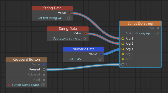

Instead of calling out to a function that is defined in a Lua script, you can enter a block of Lua script directly into the Script slot of the Script > Script Do String node. When the node's In event is triggered, your code block is evaluated within the engine's Lua environment.
As above, you can pass up to five arguments to your code block. As above, your Lua code cannot directly return any events to your Flow graph.

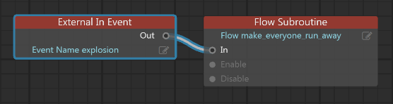

Your Lua code can fire events to your level flow or unit flow graphs at any time.
For example, if you run the following Lua code:
stingray.Level.trigger_event(myLevel, "explosion")
You can respond to it in your level flow as follows:
