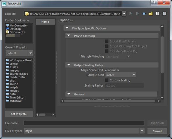

When exporting PhysX data from Maya or Maya LT to 3ds Max Interactive, ensure you specify the correct unit scaling for export. 3ds Max Interactive requires the data in meters.
You’ll find that the scaling for exported PhysX data is handled in File > Export All (or Export Selected) > Output Scaling Factor. Depending on the conversion units selected in the Output Unit, the Scaling Factor displays the scale factor for the exported units. To manually add the scale factor, enable the Custom Scaling. The Output Unit is set to meter by default.
This ensures the correct correlation between meshes, PhysX actors, and global-anchored joints in 3ds Max Interactive with the unit or coordinate system you use in Maya, and the unit you set for your FBX scene export.
