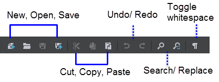

| Task overview | |
| To open an existing script | Click the Open icon |
| To save a script | Click the Save As icon |
| To create a new, blank script | Click the New icon |
| To view context-sensitive help | Hover over elements in the script. To get detailed help on an object or function from the Lua API, right-click and select API Documentation. |
| For all basic operations | You'll find that standard hotkeys apply in the Script Editor for most basic operational tasks such as undo/redo, cut, copy, paste, select all, find on the page, and so on. (Ctrl+C and Ctrl+V to copy and paste, for example). You can also right click to select some of these options from a pop-up menu. |

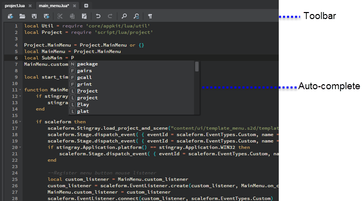

The Script Editor integrates both Lua documentation and Lua command auto-completion so that as you type, dynamic tooltips display reference information, as well as auto-complete suggestions.
| Auto-complete hotkeys | |
| Manually pop up suggestions | Ctrl + Spacebar |
| Close | Esc |
| Accept suggestion | Tab or Enter |
