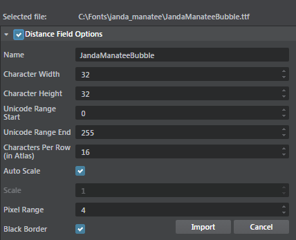

You can import font files to generate font resources to render text with sharp edges and preserve them when scaling.
Note: Fonts are imported using the Distance Field Font Importer plug-in which is loaded automatically in the Plugin Manager.
Note: MSDF (Multi-channel Signed Distance Field) does not work on all fonts, and will likely fail on more complex fonts.
In the window that appears, enable Distance Field Options, change the font settings if required and click Import.
Note: Hover over the options in this window for description. For some fonts, you may need to adjust the Character Width and Character Height settings to display with high resolution.
On import, multi-channel signed distance field resources are generated for the font. You can use the fonts to display text using Lua.
