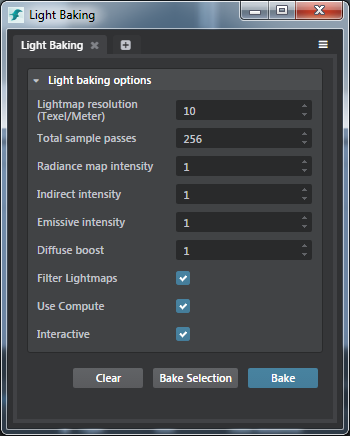

Select Window > Lighting > Light Baking from the main menu. The editor opens the Light Baking window.
In the Light Baking window, set the baking options.
Note: Hover over the other options in this dialog box for descriptions of each attribute.
Click Bake to bake your entire scene or Bake Selection to bake part of your scene.

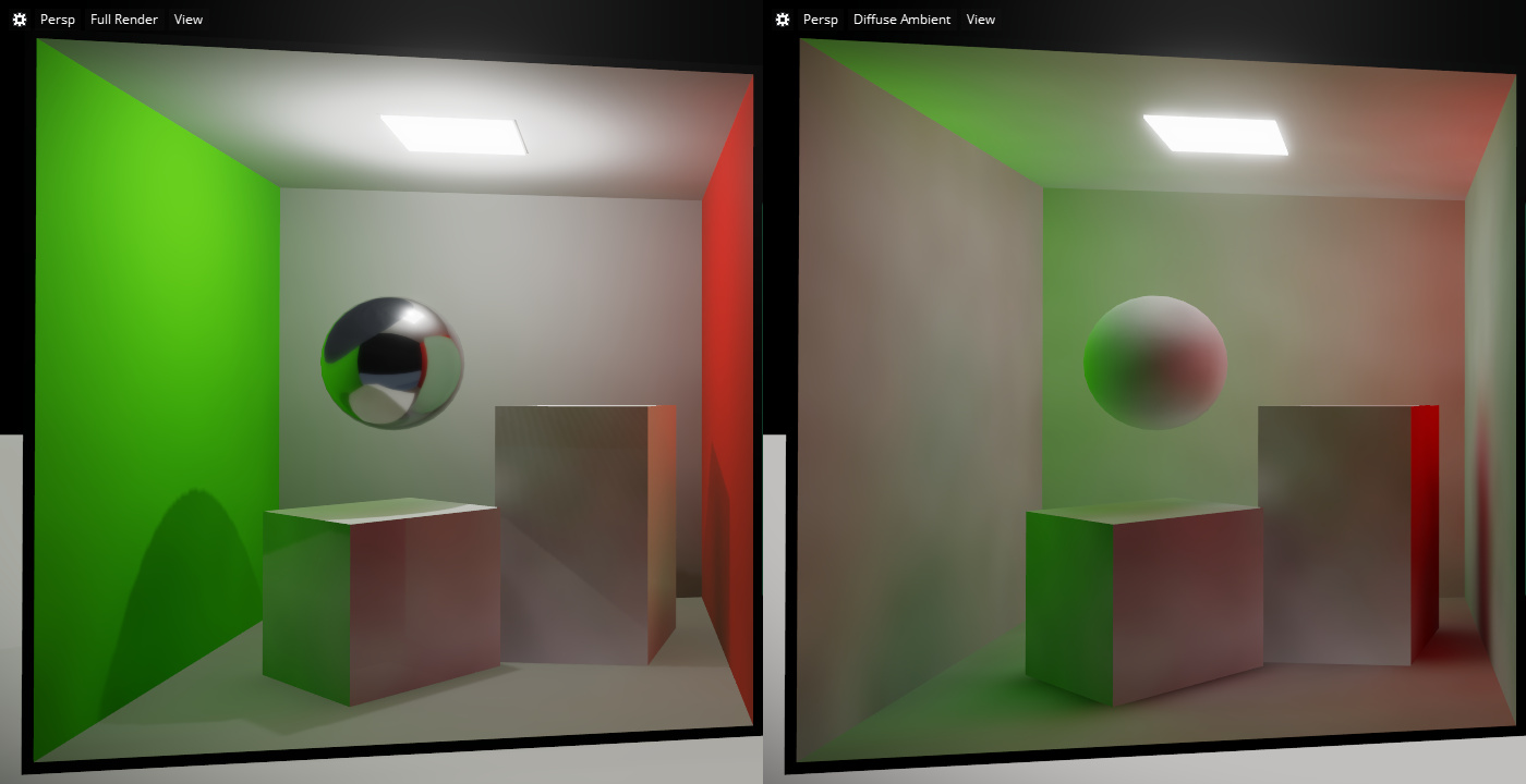

The interactive editor viewport offers a visualization mode that shows the diffuse lighting that it applies to the objects in the scene. You can use this mode to see the illumination baked into each object's lightmap projected onto that object as a texture.
For example, the image below on the left shows a fully rendered scene. The right shows only the indirect illumination stored in the lightmaps, which clearly shows the green and red colors bleeding from the side walls into the indirect light that shines on the other parts of the scene. (The color bleed is more subtle in the full render due to direct lighting from the overhead light, and due to specular reflections that are drawn from a reflection probe located in the middle of the box, not shown.)
