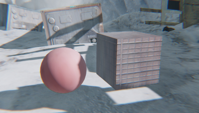

For example, the cube and sphere floating in this scene use standard physically based materials, with a frost texture applied on top as a decal:

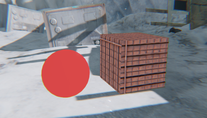

In the following image the same objects are set to use unlit materials. Note that they cast no shadows either on themselves or on each other, they are evenly lit on all sides regardless of the lights in the scene and the shading environment, and they do not receive decals.
