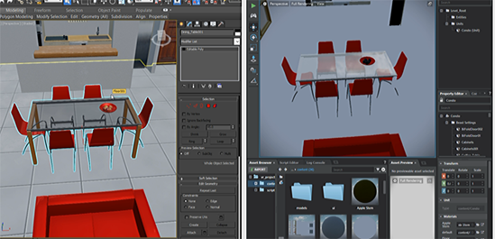

3ds Max Interactive Live Link is a powerful connection between 3ds Max and the 3ds Max Interactive engine that streamlines your 3D asset creation process and lets you create interactive architectural visualizations.
The 3ds Max Interactive Live Link provides the following:
Visual parity where any material created with Interactive (Stingray) physically-based nodes in ShaderFX are preserved when loaded in 3ds Max. See Send a material to 3ds Max and Receive materials from 3ds Max.
Live linking between 3ds Max and the 3ds Max Interactive is enabled by an interop plug-in called DCC Link, which is automatically installed in your C:\ProgramData\Autodesk\ApplicationPlugins directory when you install 3ds Max Interactive. This plug-in also adds an Interactive menu in the 3ds Max menu bar.
