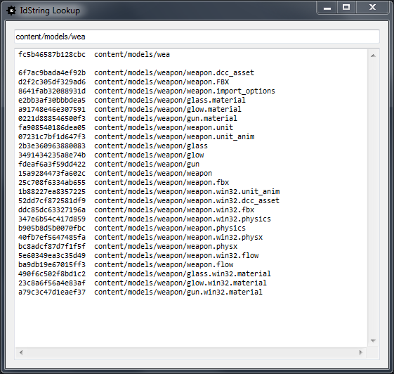

3ds Max Interactive provides a small tool for translating between source resource names and their compiled IDs.
You can get to this tool through the external console, which you will find at tools\console.exe within your 3ds Max Interactive installation directory. You can also launch the external console from the editor by choosing Window > External Console from the main menu.
Once you have the external console running, select Tools > Id Lookup from its main menu.
You can look up a resource ID by entering its name in the text field at the top, or look up a resource name by entering its ID.
