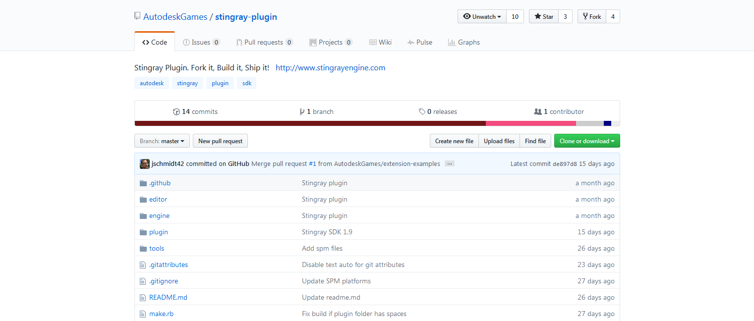

The stingray-plugin repository on GitHub is a great place to get started writing your own plug-ins. You'll find a framework all set up for you with some basic demo content, and all the tools you'll need to build libraries that extend the engine and the editor in C or C++.
For details on how to use this repository, see its main README.md file.

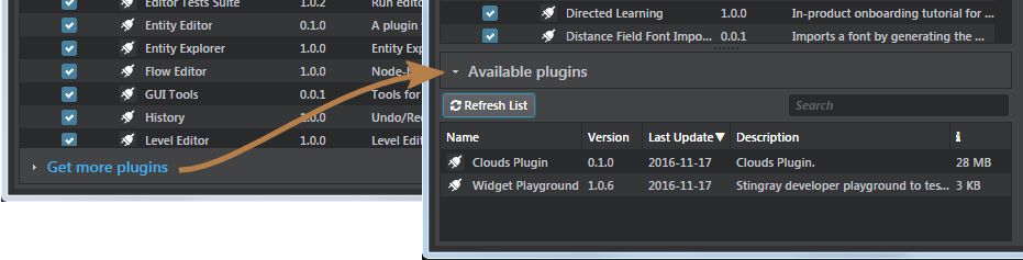

In the Plugin Manager panel of the interactive editor, you'll find some additional plug-ins that aren't installed by default, but which you can download and install with a single click. Look for the Get more plugins panel.
