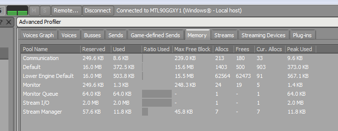

The Wwise editor contains a built-in profiling and monitoring system that you can use to track and follow the way your project loads and uses audio clips at a more granular level than the shared memory monitoring tools offered by the 3ds Max Interactive engine.
To get started profiling:
From the interactive editor, run your project on your local PC or on another connected platform.
In Wwise, choose Layouts > Profiler from the main menu.
In the toolbar, click Remote.... Select the host running the engine, if it is listed, and click Connect. If your host is not listed, try clicking Refresh or click Connect to IP... and specify the IP address.
Select the Memory tab to get an overview of the memory used by the Wwise engine:
Note that Wwise profiling is only available for Debug and Development builds of the engine, not in the final Release version.
See also the Wwise documentation about profiling and memory statistics.

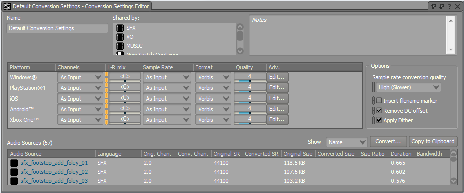

When you generate sound banks in Wwise, each audio clip in the project undergoes a format conversion for each target platform. You can change the conversion settings used for each clip on each platform.
Wwise saves your conversion settings in presets, which you can edit in the Conversion Settings Editor window. By default, when you create a new project, its corresponding Wwise project is created with the following default settings for all clips:
Ways to save memory during this conversion include reducing the number of channels (i.e. going from a stereo track to mono), lowering the sampling rate, and changing the format and quality of compression applied. All of these will affect the sound quality of the resulting clip, so be careful not to change these settings too aggressively.
To set the default preset used for all clips in the project:
To manage conversion settings for a particular clip or container:
For detailed information, see the Wwise documentation on authoring across platforms.
