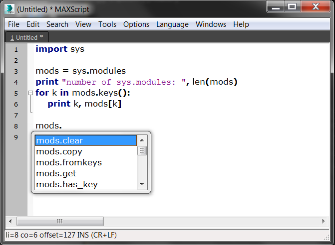

The MAXScript Editor supports Python language syntax highlighting and code completion for imported libraries. By default, the MAXScript Editor is set to MAXScript syntax when it first opens. Select Language > Python to change this to Python.
Code completion is invoked when you type a symbol and dot, or can be force-invoked by pressing Ctrl+Space.
Python scripts can be evaluated from the Editor using Tools > Evaluate All (Ctrl+E), and a single line can be executed using Tools > Evaluate Line / Selection (Shift+Enter). Note, to execute multi-line code blocks, select the block before executing this command.
