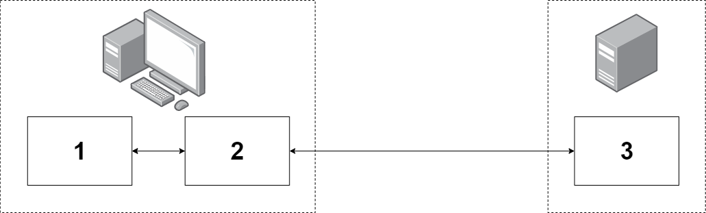

The Autodesk Licensing Service can be installed on the same machine as Moldflow Insight or on another machine on the network. Two possible configurations are illustrated below:
In Figure 1 we have a Workstation install of Autodesk Moldflow Insight and the Autodesk Licensing Service both running on the same machine:
In Figure 2 we have a typical Linux cluster setup. Each machine has a Thin-Client install of Insight which target the Autodesk Licensing Service running on a central node:
