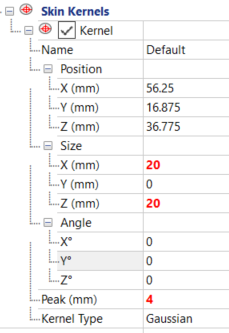

Skin Kernels tree, and in the first kernel, try the following values, but you may need to modify them for the position of your model:
- Position: use default X, Y, and Z values to place the kernel at the center of the large hole.
- Size:
20, 0, 20
- Peak:
4
- Kernel Type:

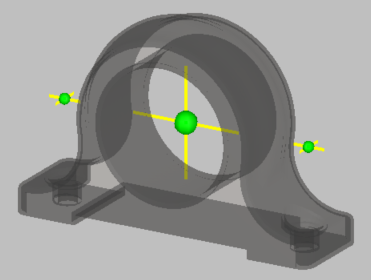

- In the new third Skin Kernel, change the
Position X value to
103.
If you click
Skin Kernels, you should see all three skin kernels, with the smaller side ones aligned in a horizontal plane, and the large center one oriented vertically.
Feel free to adjust Position values if the kernels do not appear to be symmetrically placed.
