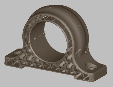

Create Component
A model of the part is created, showing lattice and skin regions, with thickening of the lattice in the kernel area.
Note that some lattice bars are poking through the skin in a few places. We will address these after optimization.

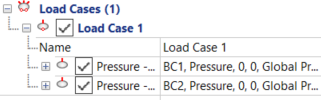

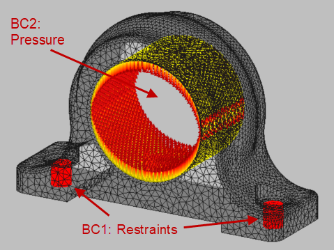

- Right-click
, and then repeat, to create two boundary conditions.

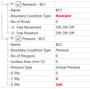

- Expand BC1 and set
Boundary Condition Type to
Restraint.
- Expand BC2. Leave
Boundary Condition Type as
Pressure, and
Pressure Type as
Global Pressure, then set the Pressure
Z value to
2e6.
- Click BC1, and use Ctrl+Left Mouse to select a small group of points inside one of the small bolt holes on each side of the part. Use Ctrl+Left Mouse to select another group of points inside the other bolt hole.
- In the
Selection panel, set the
Tolerance value to
10, then click
Flood Fill to select all points in the two holes (about 346 points).
- Click BC2, and select a small group of points inside the large hole in the part, then click
Flood Fill to select all the points inside the hole (about 3728 points).

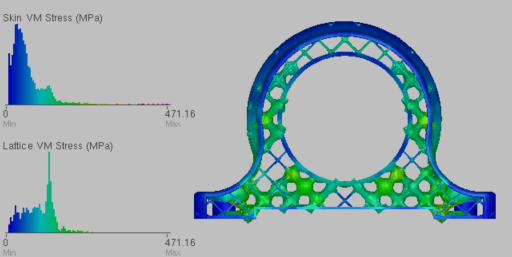

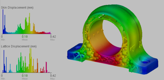

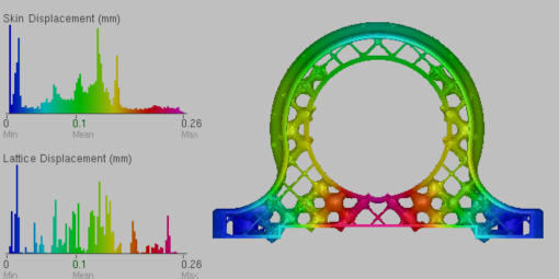

Initially, you see the Von Mises stress results, but you can also click
Displacement in the
FEA panel of the Toolbar to see Displacement results.
Simulation display options
Skin and lattice stress results
Skin and lattice displacement results

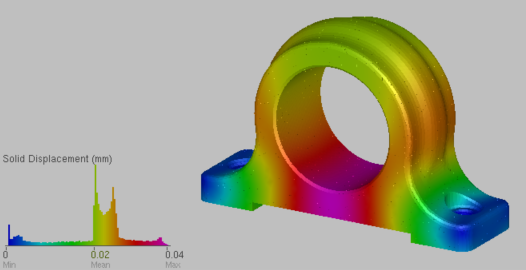

You can simulate a comparable solid part by selecting
Solid Sim from the
Simulate Component menu
Solid part displacement results
Displacement of the solid part is much less than for the lattice and skin part. The project engineers can analyze these results, and if necessary, modify the lattice properties for greater stability.

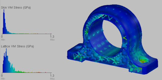

In the final optimized part, note that the thickness of lattice bars has been redistributed in the part, as optimization has decided where greater strength is required.
Post-optimization displacement results
Post-optimization stress results

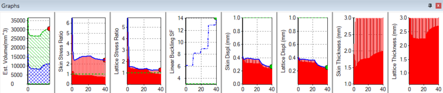

A series of optimization graphs is generated below the display area.
