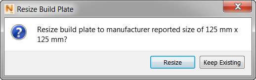

Machine model field, if you select a specific machine, the
Number of lasers is set to the number for that machine, and you are prompted to resize the build plate to the standard size for the machine.

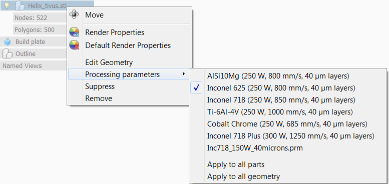

- Per geometry. The
Processing parameters field disappears, and you will select the PRM file for each part or support structure by right-clicking the geometry in the Browser.
Processing parameters displays all PRM files available in your library.
