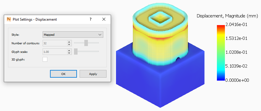

Displacement Results
The displacement results show Magnitude, but in the Display panel of the ribbon, you can use the Component control to show displacement along a single axis: X, Y, or Z. If you click Plot Settings on the ribbon, you can change the display style from Mapped to IsoSurface or Vector.
Also on the ribbon, you can
