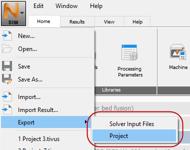

- On the Simulation menu, select Export, and then either Solver Input Files or Project.

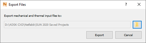

- If you selected Solver Input Files, check the proposed export path, and if you want to change it, click the folder button on the right.

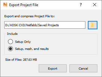

- If you selected Project, choose whether to include only the Setup files, or Setup, mesh, and results.
The size of the file package before compression is shown in the dialog.
- Note the proposed path to the saved file package, and if you want to change it, click the folder button on the right.
- Click Export.
