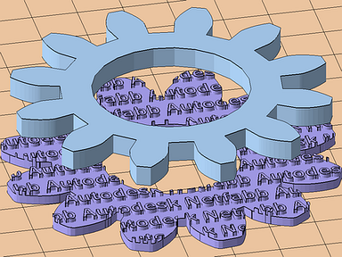

The plate type can be Solid, meaning a continuous, featureless plate, or be a grid of either Hexagonal or Rectangular pattern. If the build room contains another part, you can also select Custom Mesh: This applies the shadow area as a stencil to that mesh. (This necessarily ignores the value of Baseplate height as the custom mesh naturally has its own height.)

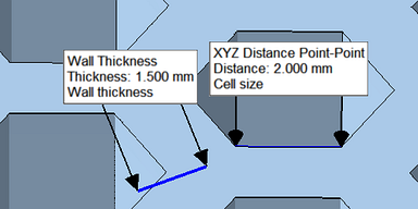

Cell size
Determines the length of the individual cells' inner sides.
Set wall thickness and cell size to adjust the grid pattern to your needs.
Wall thickness
Adds a spacing between the cells.

A spur gear with a baseplate stenciled from a custom mesh
