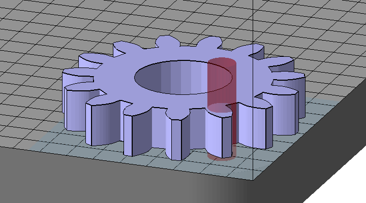

A part intersecting with a no-build zone (in transparent red) will produce a warning message upon attempting to create toolpath information.
