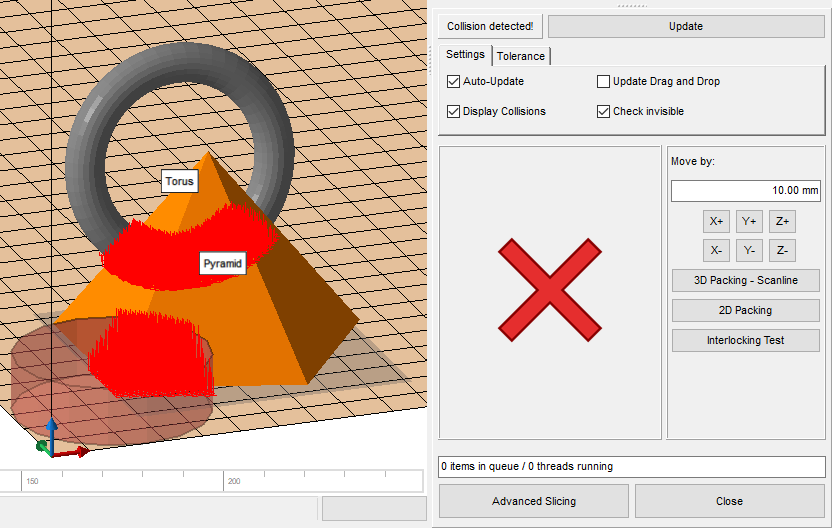

Collision detection checks whether any individual parts in the project touch or overlap with each other or with no-build zones. It is also launched automatically when using the packers.
Repair to check for
self-intersections.
This performs an initial check. You may want to adjust the settings to fit your workflow and triangle count if the impact on performance is unsuitable to keep the check updated automatically when rotating or moving the part around.
These controls appear in the context view as you use collision detection.

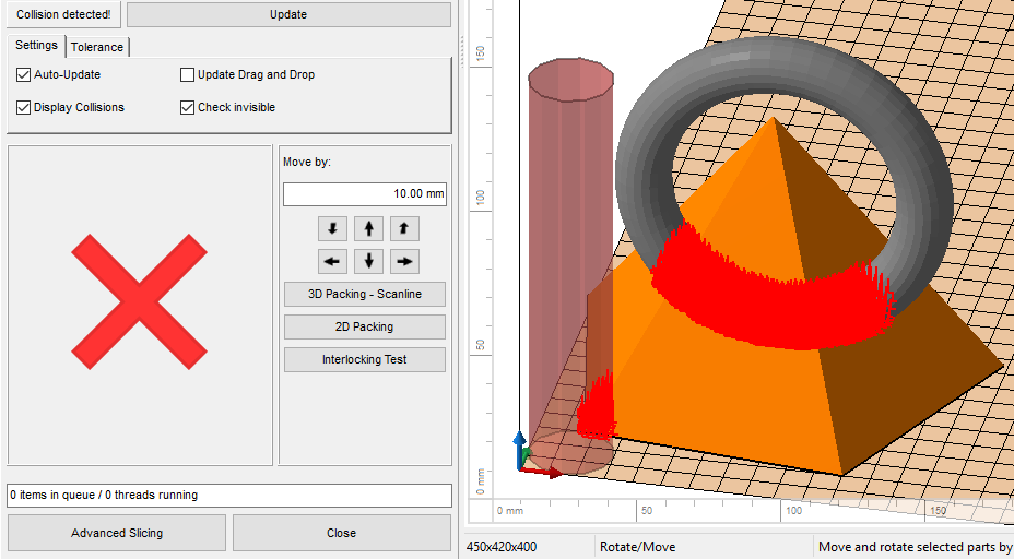

Auto-Update |
Reruns the collision check every time a part's position, size, or orientation is changed. |
Update Drag and Drop |
Reruns the collision check during rotation or moving while the mouse button is still held down. |
Display collisions |
When ticked, Netfabb renders a 3D grid over the intersecting area. When unticked, collisions are only indicated by the warning symbol, red X or green tickmark. |
Check invisible |
When unticked, hidden parts are disregarded in the collision check. |
