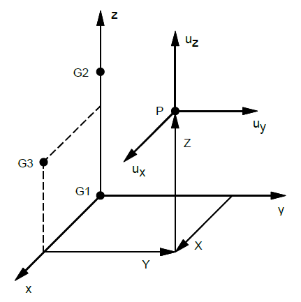

Figure 1: CORD1R definition

- GiA and GiB must be defined in coordinate whose definition does not involve the coordinate system being defined. The first point is the origin, the second lies on the z-axis, and the third lies in the plane of the azimuth origin. The three grid points GiA (or GiB) must be non-colinear and not coincident.
- Coordinate systems defined using CORD1C, CORD1R, and CORD1S entries cannot be used as reference coordinate systems on CORD2C, CORD2R, and CORD2S entries.
- The location of a grid point (P in the sketch) in this coordinate system is given by (X, Y, Z).
- The displacement coordinate directions at P are dependent on the location of P as shown above by (uX, uY, uz).
