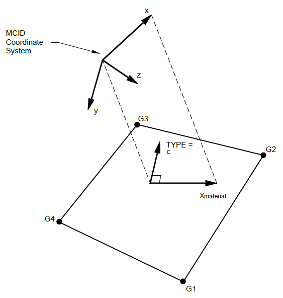

MCID Identification number of the material coordinate system. See Remark 3. Integer -1 or blank See Remark 3

  3. See the CHEXA, CPENTA, or CTETRA entry for the definition of the element coordinate system. The material coordinate system (MCID) may be the basic system (0), any defined system (Integer > 0), or the global coordinate system (-1 or blank). The default for MCID is the global coordinate system.
Figure 1: Layered solid element MCID coordinate system definition
