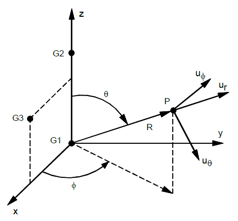

Figure 1: CORD1S definition

  3. GiA and GiB must be defined in coordinate whose definition does not involve the coordinate system being defined. The first point is the origin, the second lies on the z-axis, and the third lies in the plane of the azimuth origin. The three grid points GiA (or GiB) must be non-colinear and not coincident.
  4. Coordinate systems defined using CORD1C, CORD1R, and CORD1S entries cannot be used as reference coordinate systems on CORD2C, CORD2R, and CORD2S entries.
  5. The location of a grid point (P in the sketch) in this coordinate system is given by (R, θ, ϕ) where θ and ϕ are measured in degrees.
  6. The displacement coordinate directions at P are dependent on the location of P as shown above by (ur, uθ, uϕ).
