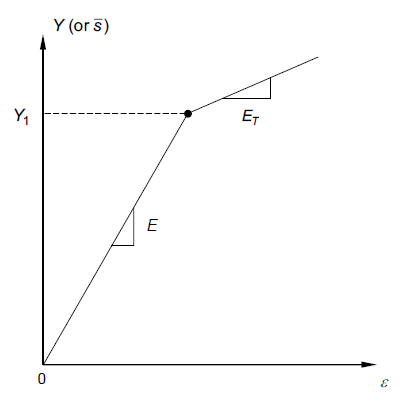

  1. Either the table identification TID or the work hardening slope H may be specified, but not both. If the TID is omitted, the work hardening slope H must be specified unless the material is perfectly plastic. The plasticity modulus (H) is related to the tangential modulus (ET) by
    where E is the elastic modulus and is the slope of the uniaxial stress-strain curve in the plastic region. See Figure 1.
    Figure 1: Stress-Strain Curve Definition When H is Specified in Field 5.
