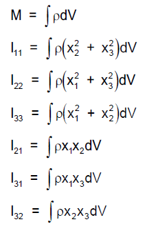

  6. The form of the inertia matrix about its center of gravity is taken as follows:
    In the equations above:
    If the CONM2 entry references a rigid body, the mass M is added to the mass that is initially computed for the rigid body, Mc. The total mass for the rigid body M is M+Mc.
    X1, X2, and X3 are components of distance from the center of gravity in the coordinate system defined in field 4. Only the magnitude of Iij should be supplied; the negative signs for the off-diagonal terms are supplied automatically. The inertia terms are transformed to the principal coordinate system for the inertia tensor for the rigid body.
