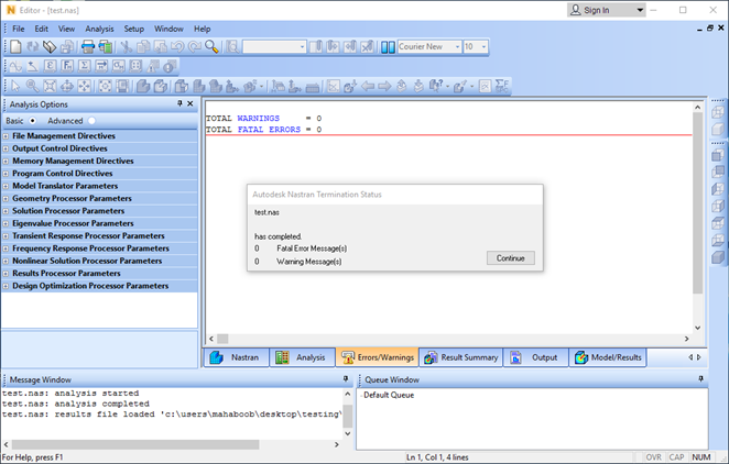

  1. Running Autodesk Nastran from the Autodesk Nastran Editor
    • You can now test Autodesk Nastran by using the Autodesk Editor to open the Test.NAS file located in the installation folder (by defaultC:\Users\Public\Documents\Autodesk\Nastran 2021\Example Files\en-us). Launch the Autodesk Nastran Editor from the Start > Autodesk Inventor Nastran 2021 > Autodesk Nastran 2021 menu item.
    • Open the Test.NAS file. Click Analysis menu > Run to run the model. The Autodesk Editor should terminate with no error or warning messages as shown in the picture below.
