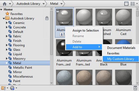

On the Materials tab, right-click the material swatch Add To the name of the library where you want the material to be added. If no custom library exists, you need to create it first.
You can add the material to multiple libraries.
Tip: Alternative way to add materials to a library is to drag the swatch to the library.
