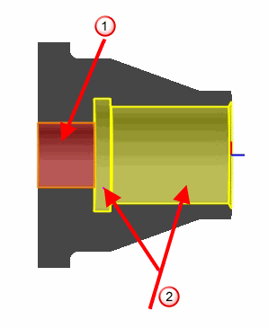

Recognized Hole — Several surfaces grouped together by PartMaker to make a hole on the solid. As well as recognizing a hole, PartMaker includes all cylinders that make at least a half circle.
Selected Wall Surface — This is the surface you have selected (see ) on the solid model to be the Major Diameter of the hole.
Marked Surfaces PartMaker uses these surfaces (see ) to calculate the Depth and Surf values for the hole.

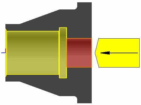

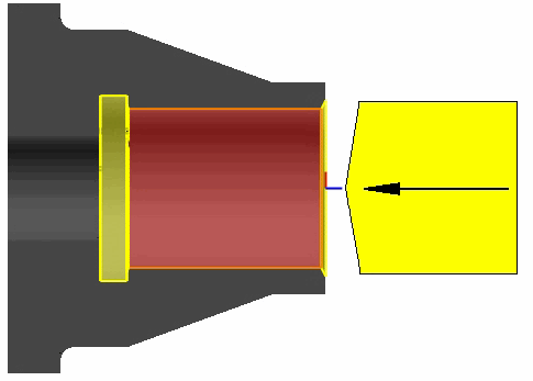

Through Hole — If, further down from the Major Diameter you selected, there is a diameter that is smaller than the Major Diameter, PartMaker does not classify the hole as a through hole. For example:

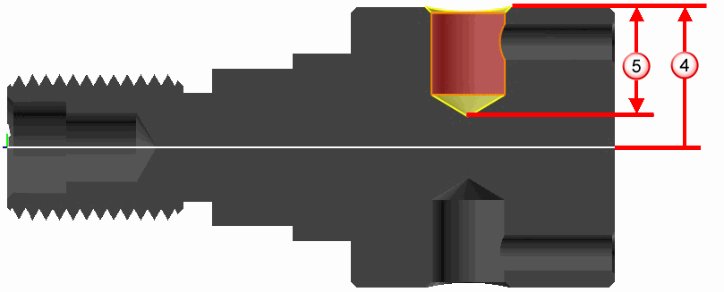

Diameter — This is the larger diameter of the wall surface you selected.

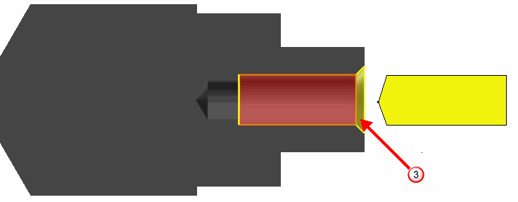

Chamfer — If the surface directly above the selected wall of the hole is a cone that reduces in diameter, PartMaker calculates this chamfer (see ) for the hole group. If there is no cone, or it is not directly above the selected surface, PartMaker sets the chamfer value to zero.
Surf PartMaker finds the top of all of the selected surfaces, relative to the Face Origin, and uses this as the Surf value (see ).
Depth PartMaker finds the depth of all of the selected surfaces, relative to the top of the hole, and uses this as the Depth value (see ).
