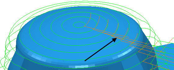

Distance — Enter the length to extend the Lead out move after the cutting move finishes. If this is an arc move, then the distance is the length of the linear tangential move between the arc and the cutting portion of the toolpath.
A Lead out of Surface normal arc with a Distance of 0, an Angle of 90 and a Radius of 5.

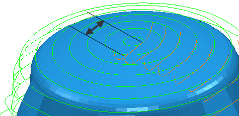

Angle — Enter the angle of the Lead out move relative to the toolpath segment. For arcs, this is the angle spanned by the arc. For lines, it is the orientation relative to the cutting move.

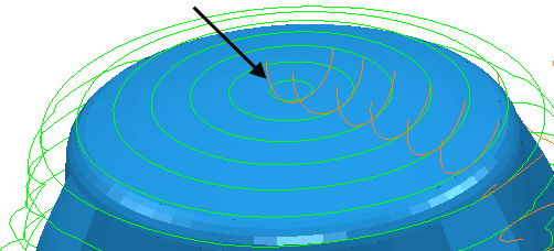

Radius — Enter the radius of the Lead out arc move.
