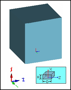

- Block — Specifies that a rectangular primitive is created, with its origin as shown below, when a parametric shape is chosen:
- H — The height dimension along the X-axis
- D — The width and depth of the base of the box.

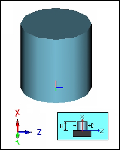

- Cylinder — Specifies that a cylindrical primitive is created, with its origin as shown below) when a parametric shape is chosen.
- H — The dimension height of the cylinder along the X-axis
- D — The dimension of the diameter for the cylinder.
