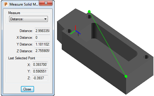

Distance
To measure the distance between two points on a solid model:
- In the
Measure Solid Model dialog, select
Distance from the
Measure drop-down list box.
- In the Solids window, select two points by clicking on the solid model.
PartMaker displays the measurement details in the dialog, including:
- the distance between the two points.
- the incremental distances between the two selected points along the X, Y, and Z axes of the part coordinate system.
- the coordinates of the last selected point in the part coordinate system.
For example:

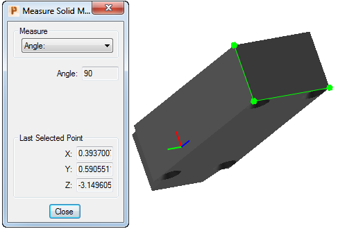

To measure the angle between three points on a solid model:
- In the
Angle from the
- In the Solids window, select three points by clicking on the solid model.
- the angle between the three points.
For example:

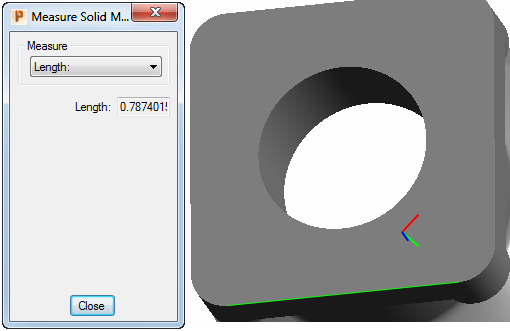

Length
To measure the length of an edge on a solid model:
- In the
Length from the
- In the Solids window, select the edge you want to measure by clicking on the solid model.
PartMaker displays the length measurement in the dialog.
For example:

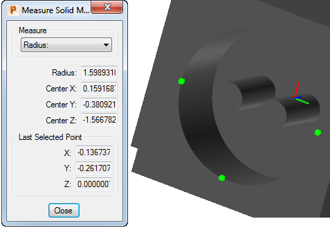

Radius
Radius
To measure the radius of an arc on a solid model:
- In the
Radius from the
- In the Solids window, select three points that form an arc by clicking on the solid model.
- the radius of the arc formed by the three selected points
- the coordinates of the center of this arc in part coordinates system
For example:
