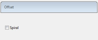

Offset (PartMaker, advanced contour milling)
Use the Offset page to specify settings for an offset-style contour mill strategy, which creates cutting moves by offsetting the model or block.
Spiral — Select this option to enable spiralling to occur (where the original offsets are closed and have one-to-one nesting).
