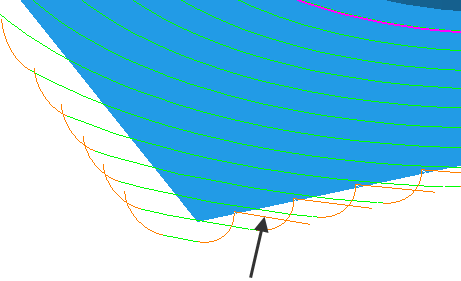

Use the Extensions page to add another lead to the existing ones.
Inward — Use these settings to add an additional Lead in before the existing one.
Extension of Straight with a Distance of 10, and an Angle of 0. Leads of Surface normal arc.
Type — Select the type of inward extension move to use. The options available are a subset of the types of Lead in move.
Distance — Enter the length of the inward extension move.
Angle — Enter the angle span of the inward extension move.
Radius — Enter the radius of the inward extension move.

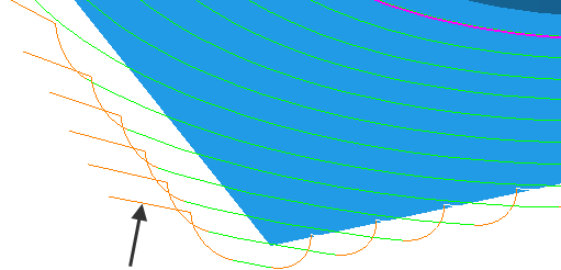

Outward — Use these settings to add an additional Lead out before the existing one.
Type — Select the type of outward extension move to use. The options available are a subset of the types of Lead out move.
Distance — Enter the length of the outward extension move.
Angle — Enter the angle span of the outward extension move.
Radius — Enter the radius of the outward extension move.
