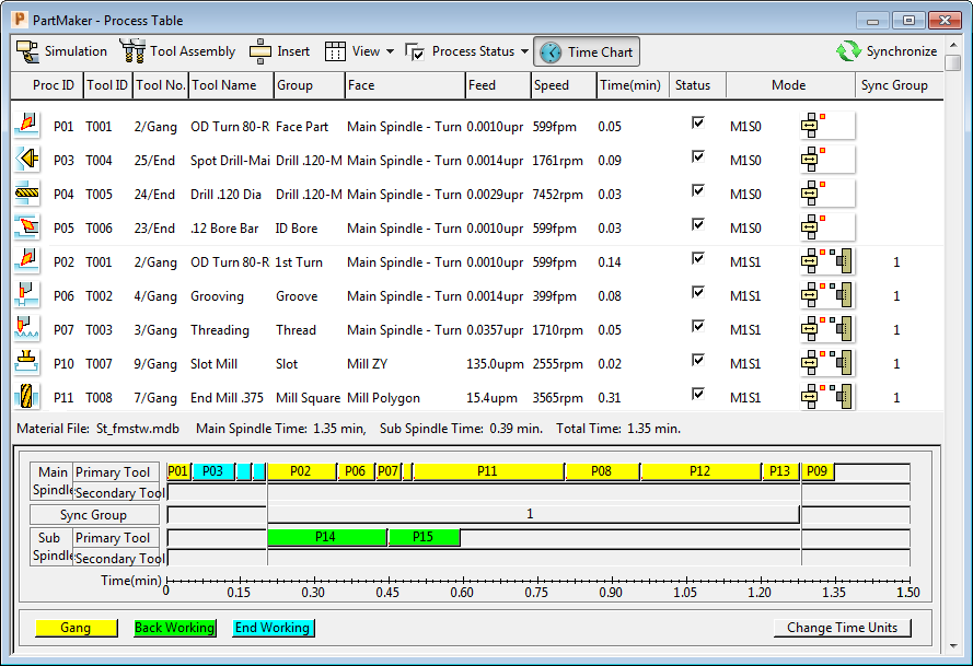

  4. When you have selected the Synchronization Mode for all processes, click the Sync Group button. PartMaker groups two or more consecutive processes with the same Synchronization Mode together into a Synchronization Group, and assigns a number to each group.
    As PartMaker groups processes into Synchronization Groups, it also verifies the Synchronization Mode settings and displays details of any errors.
  5. To view a graphical representation (known as a Time Chart) showing the results of the synchronization, click the Show Time Chart button on the Process Table.
