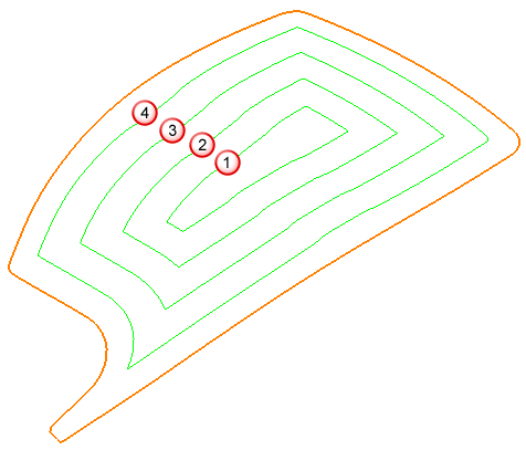

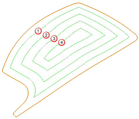

Reverse toolpath segment order — By default, toolpath segments are ordered out-to-in:
Select this option to reverse the order of toolpaths segments so they are in-to-out.
